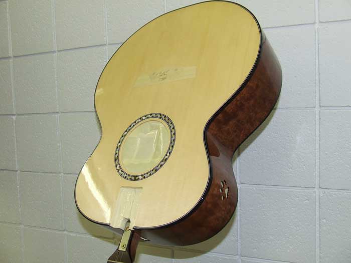

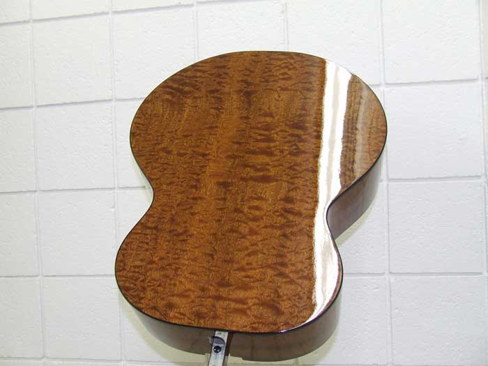

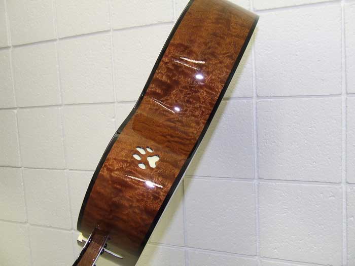

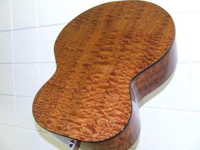

I guess Tony was taking picts today.
I too got a email from Tony
This is my 12 string Lutz/Quilted Sapele OLF SJ!!!!!
(Shane and the Zootman)
This one will have my 1st BURST!!!!!!!
A very light golden brown burst.

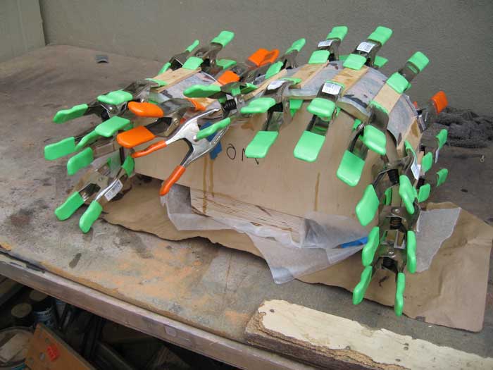

Andy, you wouldn't happen to have pics of the clamping technique for gluing up the double sides would you? Do you use a vacuum setup of some sort?
PostPosted: Thu Jun 14, 2007 5:20 am
Dave
I will take some picts later.
Basically I have made an inside half mold that is a bit smaller that the guitar. So when the sides fit over it it is the correct size. I just use thin cauls and spring clamps.    Very easy. I routed a channel in the mold to hold the clamp.
Andy
PostPosted: Thu Jun 14, 2007 5:23 am
[QUOTE=bob J] How did you bend that very difficult wood?..and any tips?
Bob I don't use Andy's double sided process but I have bent 6 sets of heavy quilted Sapele. The first two sets I bent at .09-.085 I had some minor cracking in the upper bout and waist and some minor faciting. The third set I bent at .070-.075 and had only some minor faciting. The rest of the sets I bent at .070-.075 but use that Supersoft 2 wood conditioner and had no issues at all. Sapele actually bend like Mahogany. It is the quilt that puts the bugger on the plate.
PostPosted: Thu Jun 14, 2007 5:38 am
Here is a pict of my clamping.
There is wax paper on both sides of the wood to prevent me from making my mold a single use item!!!!
The clamps just fit in the groove I routed in the sides fo the mold. I have made a mold like this for each body shape. It is just a bit smaller then the guitar to allow the thickness of the sides to give me the right dimensions
